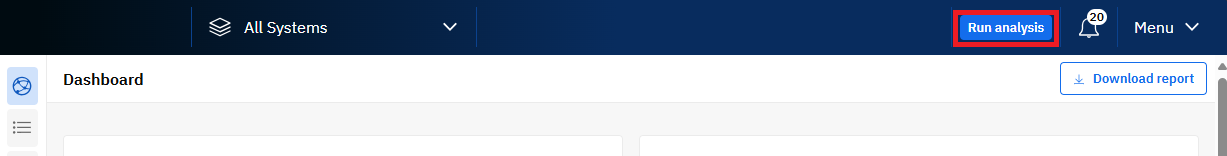

  1. Run analysis of your system(s) by selecting Run analysis.
    Screenshot showing how to run the analysis to find systems affected by VMSA-2025-0004
    Figure 4. Run the analysis to find asystems affected by VMSA-2025-0004.

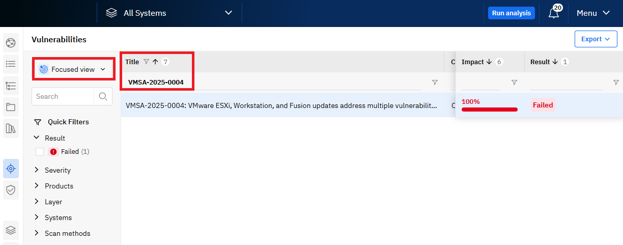

  3. In the Vulnerabilities screen, you can switch between Focused, Extended and Complete view and use filters to see whether any of your scanned systems are affected by VMSA-2025-0004.
    Toggle between vocused, extended, and complete view to find systems affectged by VMSA-2025-0004.
    Figure 6. Toggle between views to find systems affected by VMSA-2025-0004.

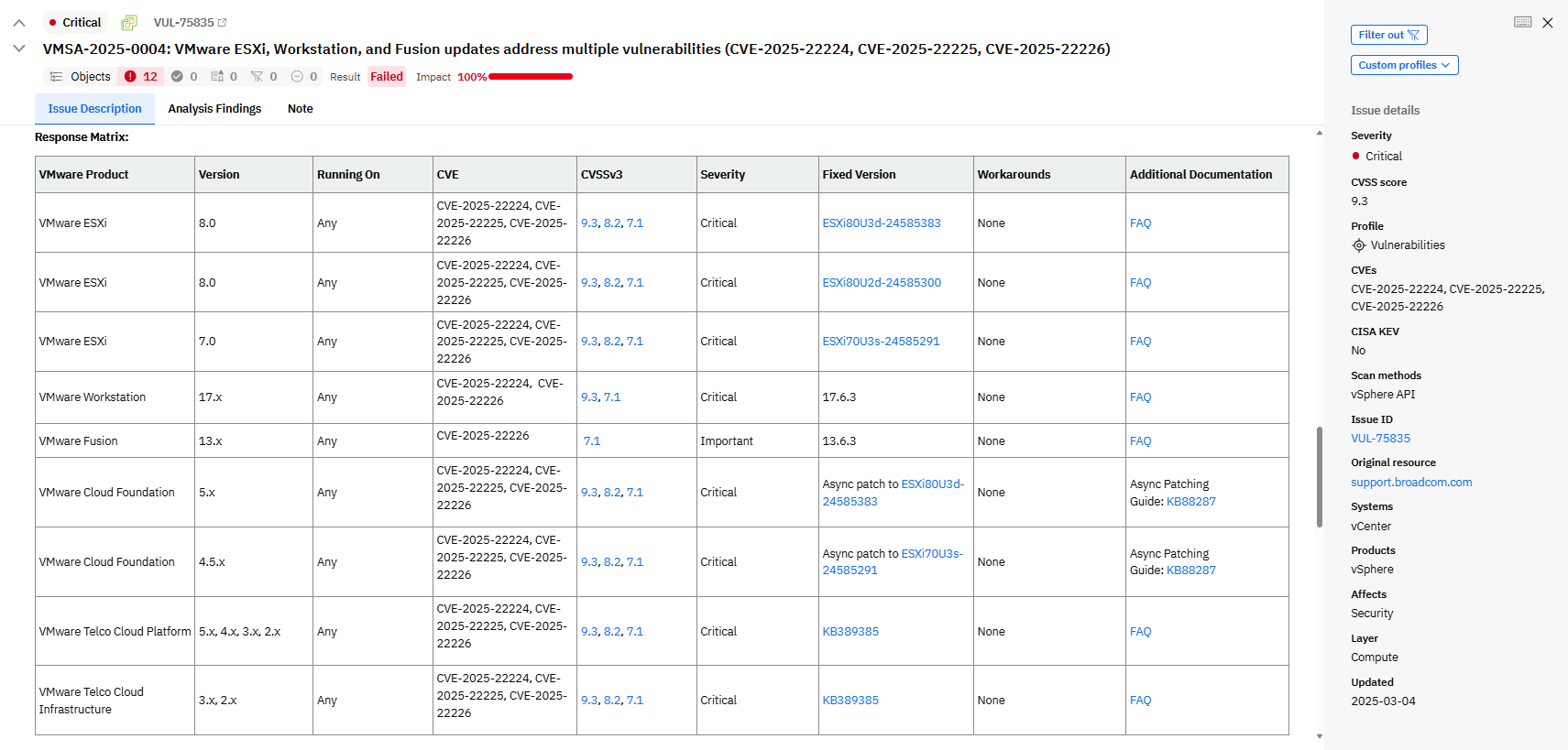

  4. If any of your systems are affected by VMSA-2025-004, the Response Matrix section provides the patch description, FAQ, and other resources provided by VMware/Broadcom.
    Table showing systems affected by VMSA-2025-0004
    Figure 7. Find systems and remediation guidance for systems affected by VMSA-2025-0004
