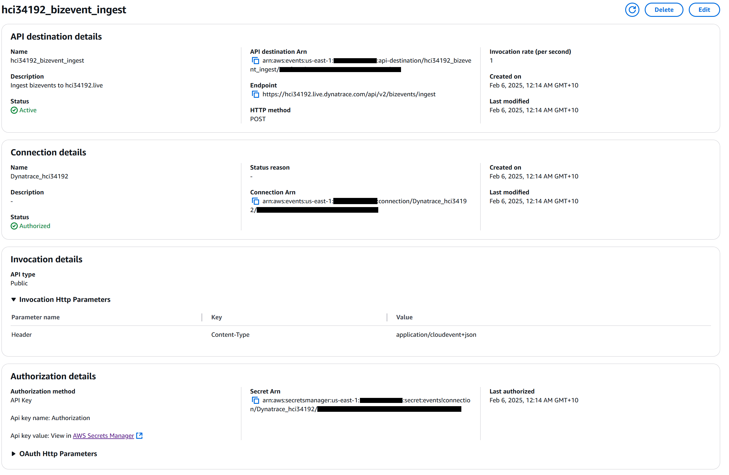

Step 2: Create the EventBridge connection
Configure invocation
Amazon EventBridge acts as the bridge between AWS and Dynatrace. Here’s how to set it up:
  1. Navigate to Amazon EventBridge
Log in to your AWS Management Console and go to EventBridge > Connections.
  1. Recreate the cURL command
You can use this cURL command as a reference to establish your connection:
curl -X POST \
'https://abc12345.live.dynatrace.com/api/v2/bizevents/ingest' \
-H 'Authorization: Api-Token dt0c01.*****.*****' \
-H 'Content-Type: application/cloudevent+json' \
-d '{…}'
  1. Set the Authorization Method
Create a new EventBridge connection with the Authorization Method set to “API Key” and use the API token from Step 1 as the value (i.e., “Api-Token dt0c01.*****.****”).
Reminder: The API token is a sensitive value and should be stored in an encrypted format using a tool like AWS Secrets Manager. When following this guide, AWS Secrets Manager is already used.

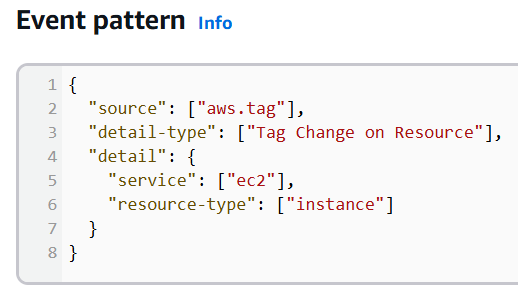

  1. Set the event pattern
Create a rule in EventBridge with the following event pattern:
  "source": ["aws.tag"],
  "detail-type": ["Tag Change on Resource"],
  "detail": {
    "service": ["ec2"],
    "resource-type": ["instance"]

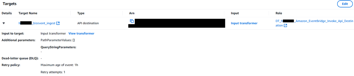

  1. Apply targets and permissions
Assign targets and permissions to ensure successful data ingestion into Dynatrace. Use an IAM role to permit EventBridge to call your API destination.

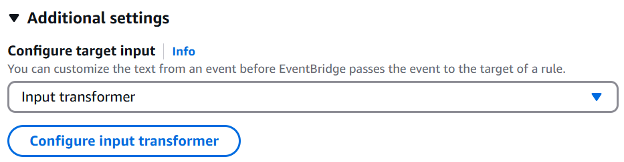

Input transformer
The input transformer should be set as follows:
{"detail":"$.detail","id":"$.id","region":"$.region","resources":"$.resources","source":"$.source","time":"$.time"}

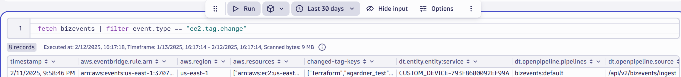

  1. Confirm data in Dynatrace
Within Dynatrace, press CMD/Ctrl + K and search for “Notebooks.” Create a new notebook and run the following query:
fetch bizevents | filter event.type == "ec2.tag.change"
If the query returns results, your configuration is working correctly.

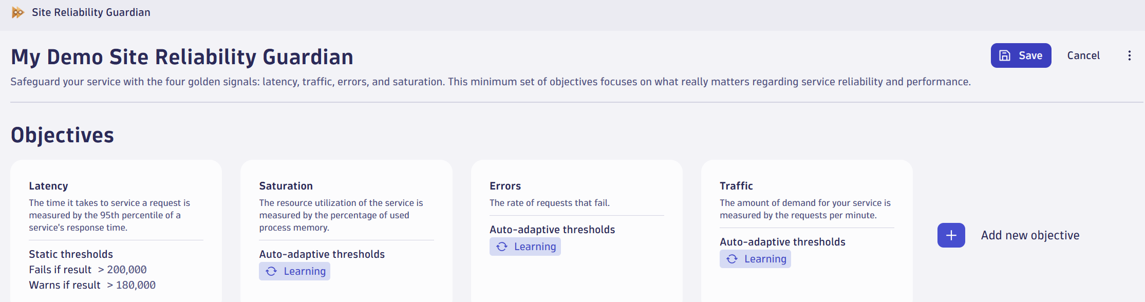

  1. Create a new guardian
In Dynatrace, search for “Site Reliability Guardian” (`CMD/Ctrl + K`) and create a new guardian. For best practices, use the “Four Golden Signals” template.

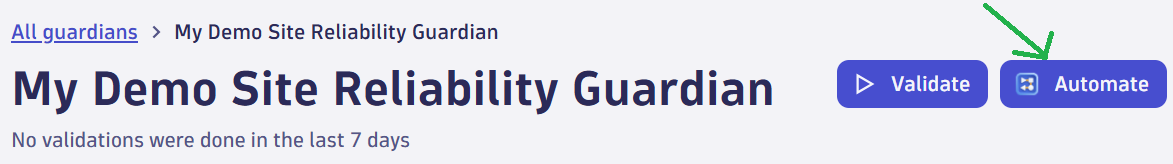

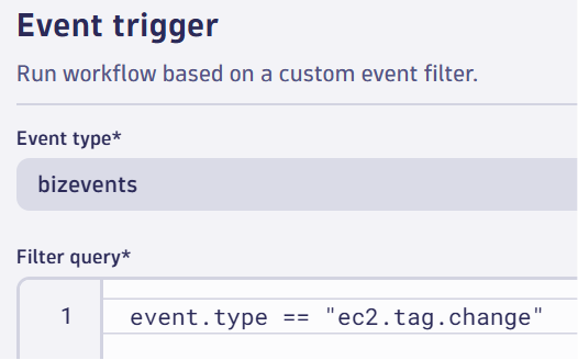

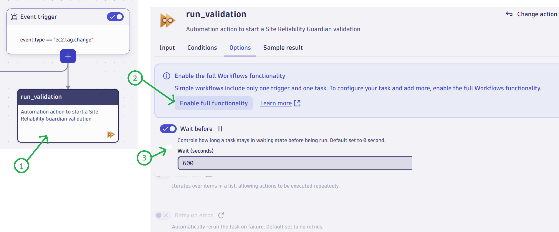

  1. Automate the workflow
Either on the overview page showing all guardians or on the analysis page of a selected guardian, click the Automate button. This will generate a workflow that triggers the guardian based on incoming bizevents (Business events). Configure the event type as `bizevent` and set the filter query to:
  1. Add a pause
To allow your systems to stabilize before triggering the guardian, add a “wait before” step. For example, set a delay of 600 seconds (10 minutes).
Example timeline:
  • 06:59: Tag changed on EC2 instance.
  • 07:00: EventBridge triggers the workflow.
  • 07:10: Guardian is executed after 10-minute pause.
