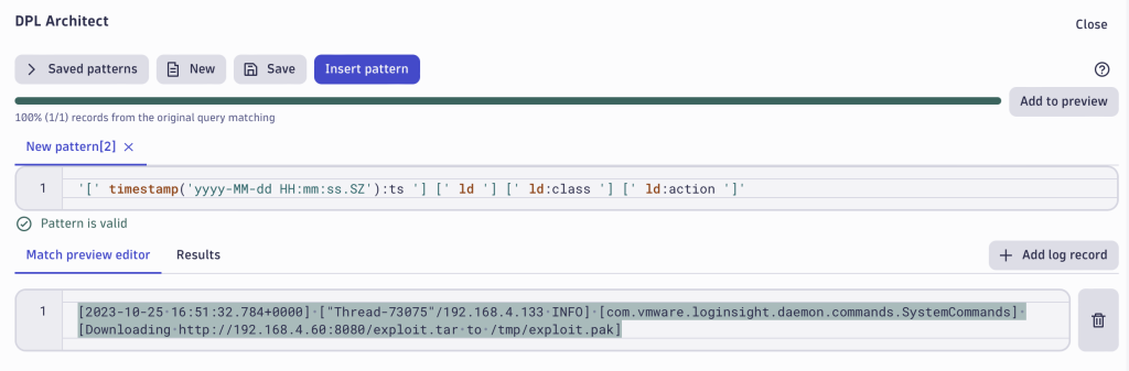

Now, let’s fire up the DPL Architect and create a suitable pattern for this line:
MVware Aria Operations for Logs DPL example
With the created DPL pattern, you can extract the timestamp field ts, the logger class name as class that populated the log lines and the action that was written to the log record. These extracted fields give you the option to filter out the relevant records:

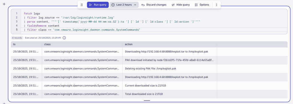

MVware Aria Operations for Logs DPL example to filter out records
However, there’s another goal to keep in mind: you need all the log records that contain the Downloading statement and URL from where the tarball was loaded and the destination path in /tmp/.

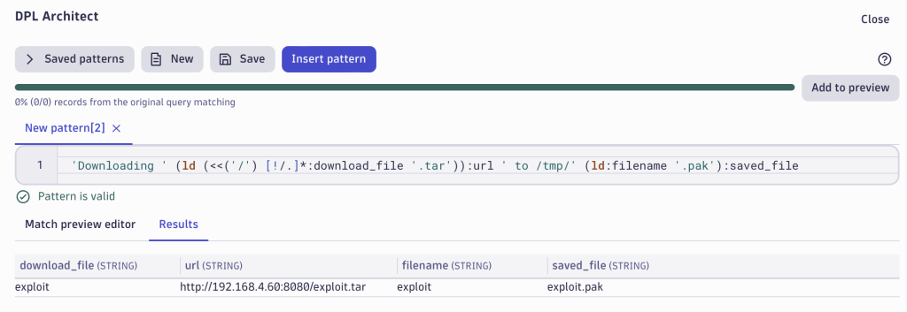

Let’s continue with our DPL pattern and extract the full URL where the payload was downloaded and the relevant filenames. Again, we’re opening up the DPL Architect and creating the following pattern:
'Downloading ' (ld (<<('/') [!/.]*:download_file '.tar')):url ' to /tmp/' (ld:filename '.pak'):saved_file
With the created pattern, we’re extracting the url and the tarball’s name as download_file into separate fields using the look-around functionality of DPL. Additionally, we’re extracting the filename from the destination file path as well as the whole saved_file value for simpler analysis.
DPL pattern extracts the following result set from the log record:
DPL Architect screenshot

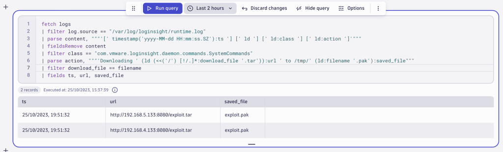

Applying this pattern and filtering the records as described in the blog post gives you the following DQL query:
fetch logs
| filter log.source == "/var/log/loginsight/runtime.log"
| parse content, """'[' timestamp('yyyy-MM-dd HH:mm:ss.SZ'):ts '] [' ld '] [' ld:class '] [' ld:action ']'"""
| filter class == "com.vmware.loginsight.daemon.commands.SystemCommands"
| parse action, """'Downloading ' (ld (<<('/') [!/.]*:download_file '.tar')):url ' to /tmp/' (ld:filename '.pak'):saved_file"""
| filter download_file == filename
| fields ts, url, saved_file
The query produces the following result, which you can now pass on to your administrator for manual evaluation.
